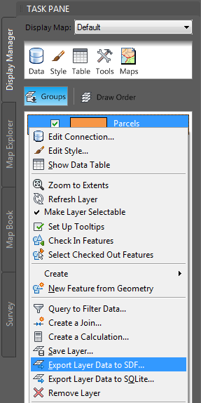

- In Display Manager, right-click the Parcels layer and click Export Layer Data To SDF.
Save the layer to a new SDF file to make the joined attributes available for editing.

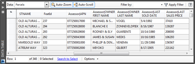

- In Display Manager, select the Parcels layer from the new SDF file and click Table.
- In the Data Table, scroll to the right.
The joined properties are no longer gray. They are native properties of the new SDF file.
