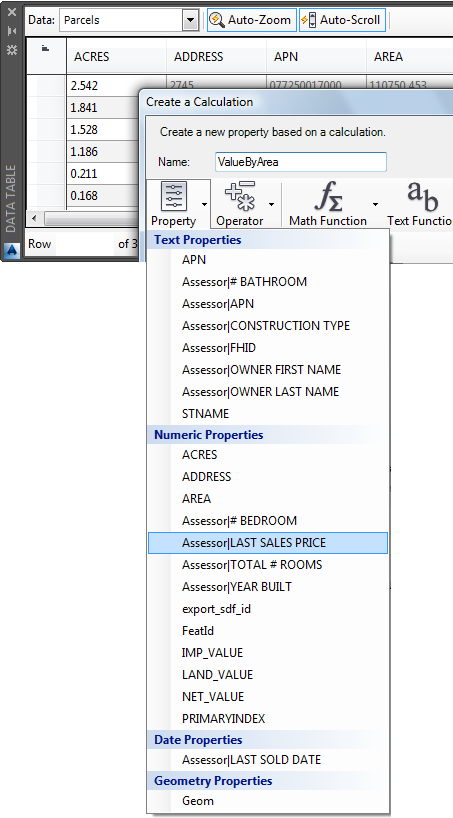

  2. At the bottom of the Data Table, click OptionsCreate A Calculation.
  3. In the Create A Calculation dialog box, name the calculated property “ValueByArea.”
  4. Click Property. Under Numeric Properties, select Assessor| LAST SALES PRICE.

  7. Hold your cursor inside the parentheses, where you see the text “geometry property.” On the tooltip that displays, click Enter A Property.
  8. From the Property list, select Geom (at the bottom of the list).
    Every spatial feature has a geometry property that you can use to calculate area or length.
  9. Click Validate to make sure that the expression is a valid calculation.
  10. When you see “The expression is valid,” click OK to create the calculated property and return to the Data Table.
