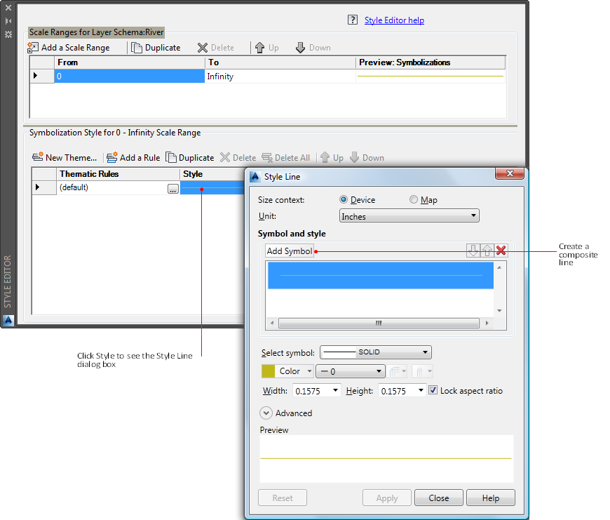

  5. In Display Manager, select the Roads layer and click Style.
    Note:
    If the Style Editor is docked, move your cursor over it to display it. It might be docked at the left side of the application window.
  6. In the Style Editor, click the Style field.
  7. In the Style Line dialog box, click Add Symbol.
    Use Add Symbol to combine line styles.
  8. Do the following:
    • Change Unit to Millimeters.
    • Change the line thickness to 2.
    • Change the Color to black If it is not black already).
    This is the bottom line of the composite style.
  9. Create the second part of the line style.
    • Select the top line in the Symbol And Style area.
    • For Select Symbol, choose a dashed line pattern.
    • Leave the line color set to yellow (or change it to yellow if it is a different color)
    Notice that the preview now displays a dark line with a dashed yellow line inside it.
    A composite line for roads
  10. Click Apply and then click Close.
