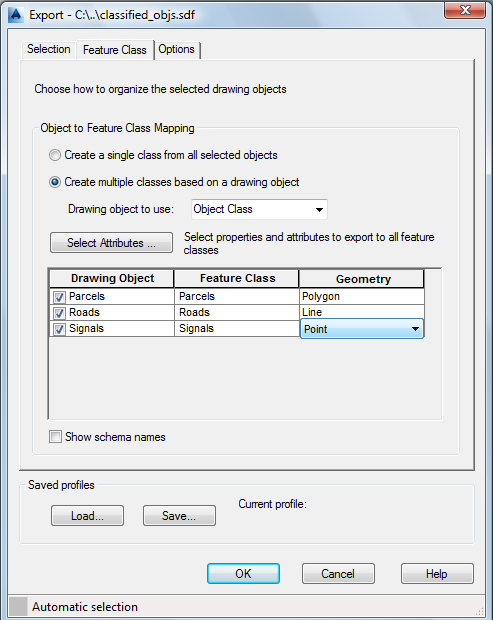

  6. In the Export dialog box, click the Feature Class tab and do the following:
    • Under Object To Feature Class Mapping, click Create Multiple Classes Based On Drawing Object.
    • For Drawing Object To Use, select Object Class.
    • Click Select Attributes.
  7. In the Select Attributes dialog box, expand the Object Classes item and select all three object classes. Click OK.
    The new SDF file will contain one feature class for each object class you selected. The properties of each feature class match the attributes of its corresponding object class.
  8. On the Feature Class tab of the Export dialog box, under Object To Feature Class Mapping, specify the appropriate Geometry entry:
    • For Roads, select Line.
    • For Parcels, select Polygon.
    • For Signals, select Point.
    Use object classes to create feature classes, specifying the geometry type for each one.
  9. Click OK.
