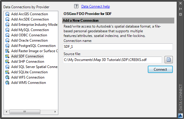

  3. In the Data Connect window, do the following:
    • Under Data Connections By Provider, click Add SDF Connection.
    • For Source File, click the file icon next to the field.
    • Navigate to the SDF file you created in Exercise 1: Export object classes to SDF.
    • Select the file and click Open.
    • Click Connect.

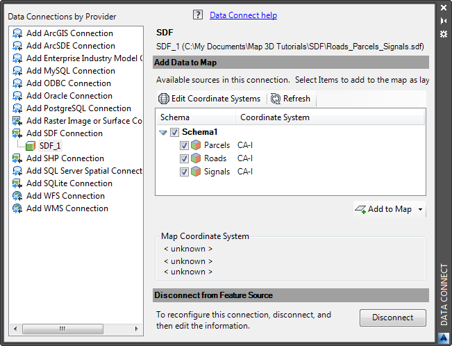

      Specify the file to connect to.
    • Under Add Data To Map, select all three feature classes listed.
      Select the feature classes and add them to the map.
    • Click Add To Map.
