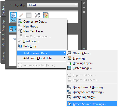

You can use Display Manager to attach an AutoCAD drawing file.
This exercise uses the build_map1.dwg map you created in the previous exercise.
If you are connected to the Internet, play the video to see how to attach an AutoCAD drawing to your map. You can also click "Let Me Try" to try it yourself. The steps for this procedure are listed below the video. |
To attach an AutoCAD drawing file
When you attach a drawing, it is not listed in Display Manager and it does not appear in your map. However, it is listed on the Map Explorer tab of the Task Pane under Current Drawing.
You “query in” objects from the drawing to use in your map, as demonstrated in the next exercise.
