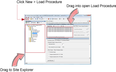

In Autodesk Infrastructure Studio, there are three ways to load your source files:
Load procedures are displayed in the Site Explorer as resources. You can reuse them, copy them, or modify them. Load procedures are essentially saved scripts for reloading data. You can use load procedures to automate the updating of resources on the server. They capture the location of the source files, the conversion rules, and where to put the resulting data on the server. You can execute these rules (either interactively in Autodesk Infrastructure Studio or through a script) to refresh file-based spatial data on your site. Scripts can be run overnight at regular intervals to keep the data up-to-date.
