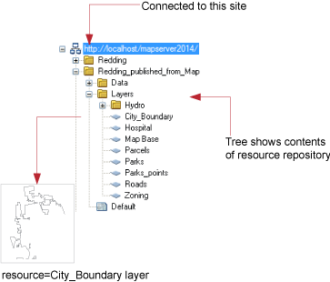

All resources are stored in the resource repository on the site server. When you open Autodesk Infrastructure Studio and connect to your site server, the contents of the resource repository are displayed in the Site Explorer.
The Site Explorer provides a view into the resource repository
