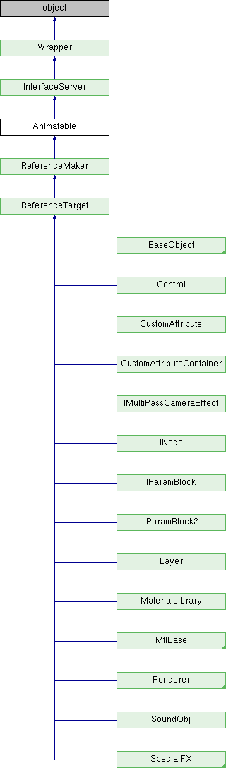

The base class for most scene entity and plugin types.
+ Inheritance diagram for Animatable:
