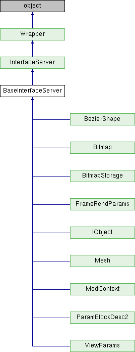

BaseInterfaceServer Class Reference
Class Description
Enables enumeration of interfaces supported by an object.
+ Inheritance diagram for BaseInterfaceServer:
