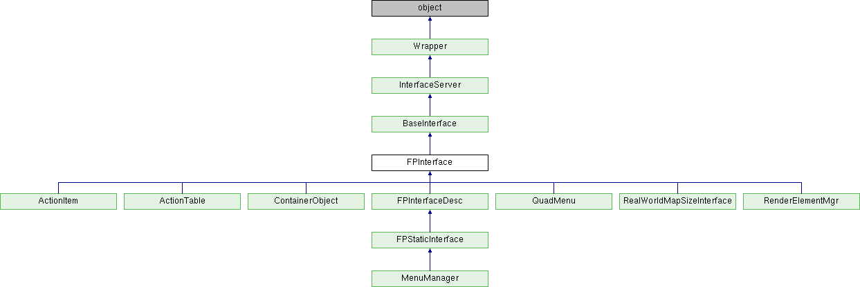

Class Description
The base class for defining function published interface classes. Function published interfaces are exposed automatically to MAXScript
+ Inheritance diagram for FPInterface:
