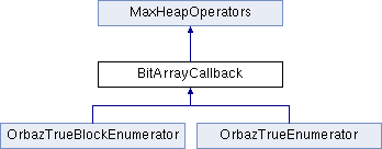

+ Inheritance diagram for BitArrayCallback:

Implemented in OrbazTrueBlockEnumerator, and OrbazTrueEnumerator.
