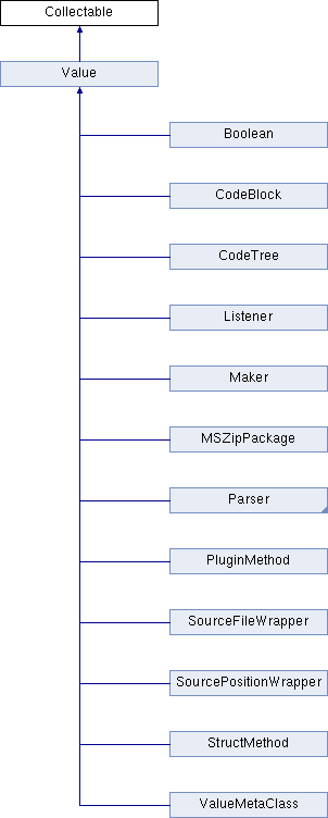

#include <collectable.h>
Inheritance diagram for Collectable:Public Member Functions | |
