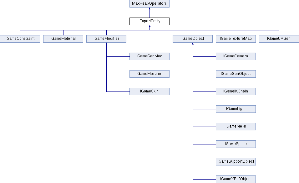

base Class used by all exporters participating in the properties system
+ Inheritance diagram for IExportEntity:
