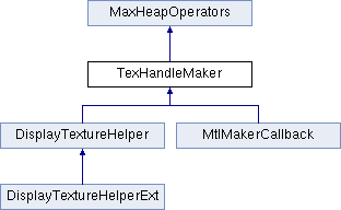

+ Inheritance diagram for TexHandleMaker:
