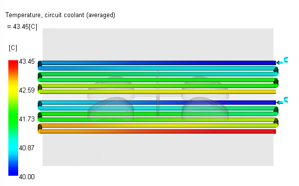

Click Temperature, circuit coolant (averaged) in the study tasks list.
The increase in temperature is best when less than 2-3 C. The core is slightly more than the guideline.

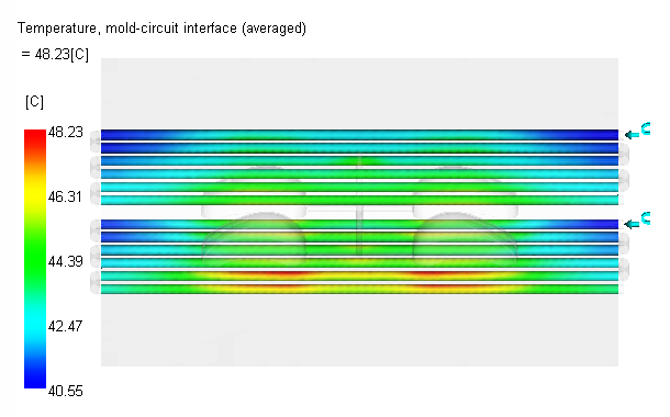

Click Temperature, mold-circuit interface (averaged).
This result is best when less more than 5C above the coolant inlet. There are places in the core that is more than this desired value.
