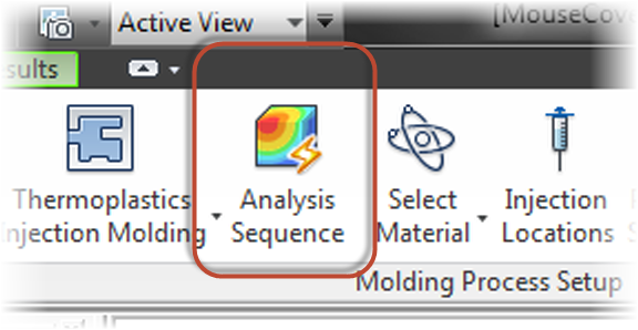

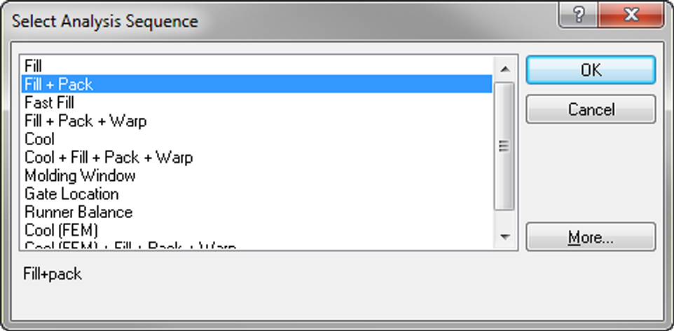

In this task, you use the set the analysis sequence to Fill + Pack.
Click Home tab > Molding Process Setup > Analysis Sequence.
Click Fill + Pack.
Click OK.
Click Home tab > Molding Process Setup > Select Material.
Verify that the Manufacturer is LG Chemical and that the Trade Name is ABS HG-173.
