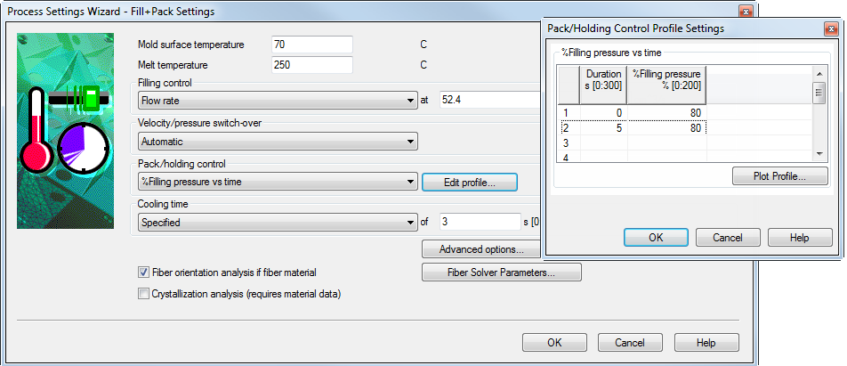

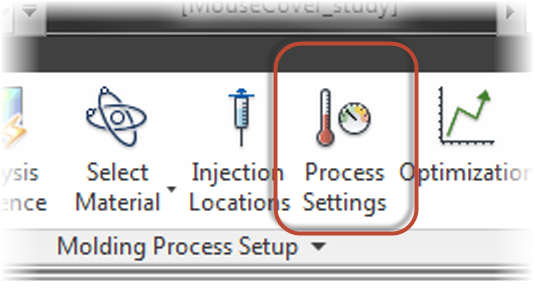

In this task, you use the input the process settings and run the analysis.
Click
Ensure that the Mold surface temperature is 70° C
Ensure that the Melt temperature is 250° C
Set the Filling control to Flow rate of 54.2 cm^3/s
Click Edit Profile
Set the profile 0 - 80%, 5 - 80%
Click OK twice.
The process settings look like the image.
