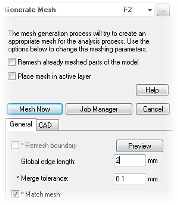

  2. Click (Mesh > Mesh > Generate Mesh) to display the generate mesh panel.
  3. Enter 2 (mm) as the Global edge length , then click Mesh Now.

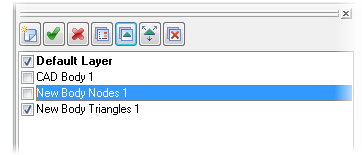

  5. Deselect the New Body Nodes 1 layer in the layers panel.
