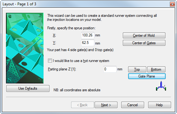

  1. Click Home > Geometry > Create Runner System.
  2. Click Center of Gates.
  3. Click Gate Plane, then click Next.
  4. Enter 5.5 mm as the orifice.

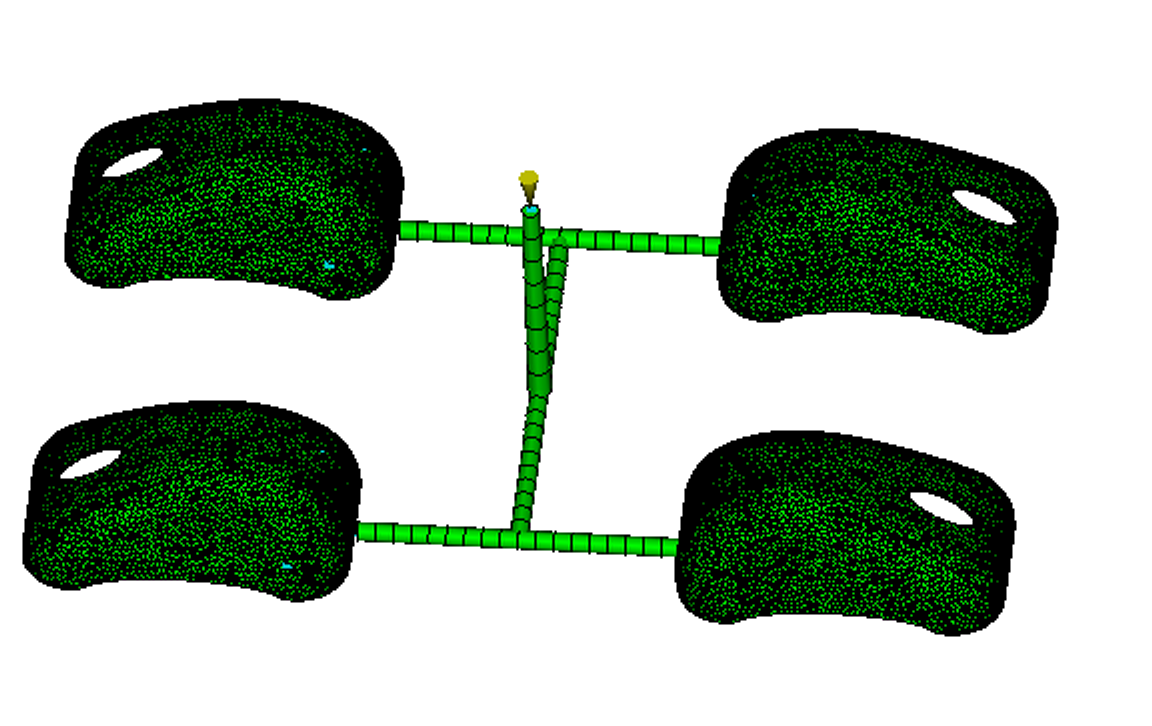

  8. Enter 2 mm as the Orifice.
  9. Enter 0 as the included angle.
  10. Enter 1 mm as the Length, then click Finish.
    The study looks like the image.

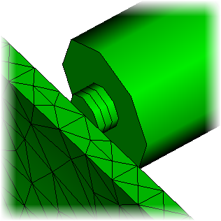

  11. Zoom up on one of the gates, similar to the image.
  12. Activate the Select tool from the Navigation bar on the right side of the Synergy window.
  13. Select one element in the gate, as shown.

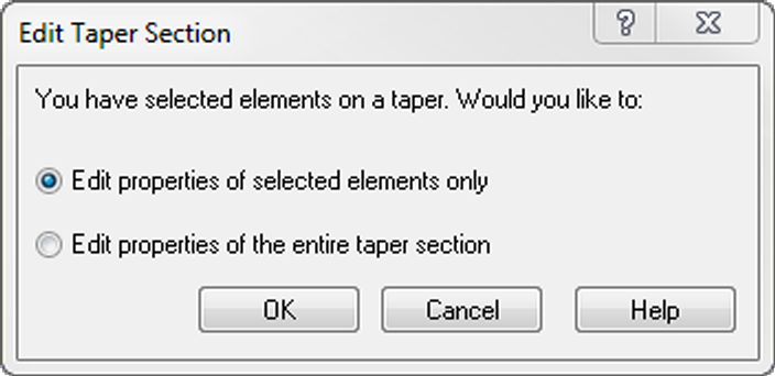

  14. Click Geometry > Properties > Edit.
  15. Select Edit properties of selected elements only, then click OK.
