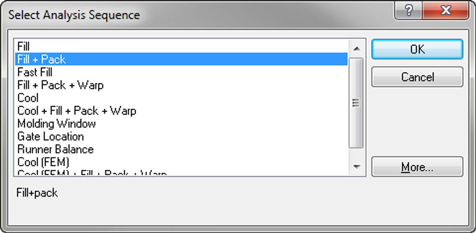

In this task, you use the set the analysis sequence to Fill + Pack.

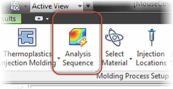

  1. Click Home tab > Molding Process Setup > Analysis Sequence.
  2. Click Fill + Pack.
