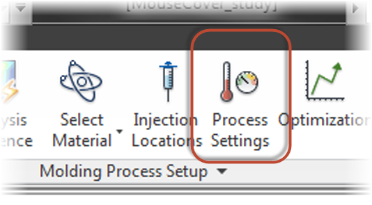

  1. Click (Home tab > Molding Process Setup panel > Process Settings).

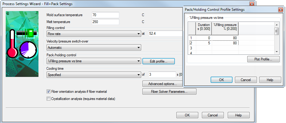

  2. Ensure that the Mold surface temperature is 70° C
  3. Ensure that the Melt temperature is 250° C
  4. Set the Filling control to Flow rate of 54.2 cm^3/s
  5. Click Edit Profile
  6. Set the profile 0 - 80%, 5 - 80%
  7. Click OK twice.
    The process settings look like the image.
