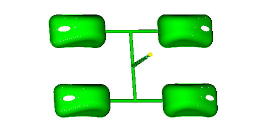

Import a Study
In this task, you import an existing Study.
  1. Click Home > Import > Import.
  2. Navigate to the location of the Study file you downloaded.
  3. Select the file MouseCover4cavity.sdy and click Open.
  4. Use the View Cube and Navigation bar on the right to move the model around the screen.
