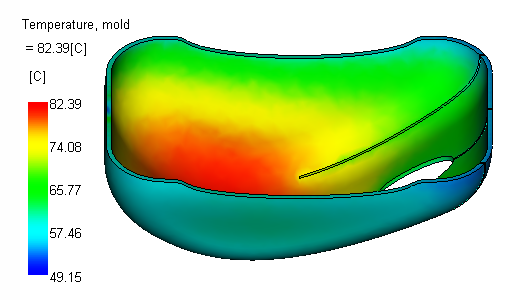

In this tutorial, you set up and run a boundary element method (BEM) cooling analysis on a 4-cavity tool on the computer mouse cover. The BEM cooling analysis calculates a steady state, or average temperatures over the entire mold cycle. At a minimum, all you need for this analysis is a model of the molded part and cooling channels. With this method, it is easy to modify the location of the cooling channels to see the influence of the cooling channel location. Inserts are created to represent areas of the tool made of different materials, typically materials with a high thermal conductivity.
