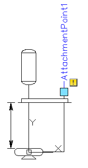

You define attachment points in a block with the Block Editor and Point parameters. Each Point parameter that you want to use as an attachment point must follow a specific labeling convention, "AttachmentPoint" + [Numeric Suffix]. For example, the first attachment point for a block would be labeled AttachmentPoint1, the second attachment point would be labeled AttachmentPoint2, and so on.
If you are defining an attachment point in a block for a valve or inline instrument, also define the rotation angle of the end connection by using the labeling convention "AttachmentPoint" + [Numeric Suffix] + ":EndCode" + [Rotation Angle in Degrees].
For example, a block has a Point parameter with the label AttachmentPoint1:EndCode90 for one of its attachment points. The label AttachmentPoint1:EndCode90indicates that it is the first attachment point for the block and that the end connection at the attachment point is rotated 90 degrees. If you do not want to use end connections with a block for a valve or inline instrument, use the labeling convention "AttachmentPoint" + [Numeric Suffix].
