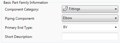

  3. In Basic Part Family Information, click a component category (for example: Fittings).
  4. Click a Piping Component type (for example: Elbow).
    The piping component type is the Plant 3D class.
  5. Enter a Short Description (for example: ELL 90, SEGMENTED).
  6. Click a Primary End Type (for example: BV). You can also enter a value if the Primary End Type is not in the catalog.

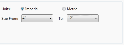

To add a new component to a catalog
    (continued from To set new component geometry)
  1. In Size From, specify an initial size range. For Example, 4” to 12”.
    Sizes can be added and removed after the part is added to the catalog.
  2. Click Create.
    The component is added to the catalog editor.
