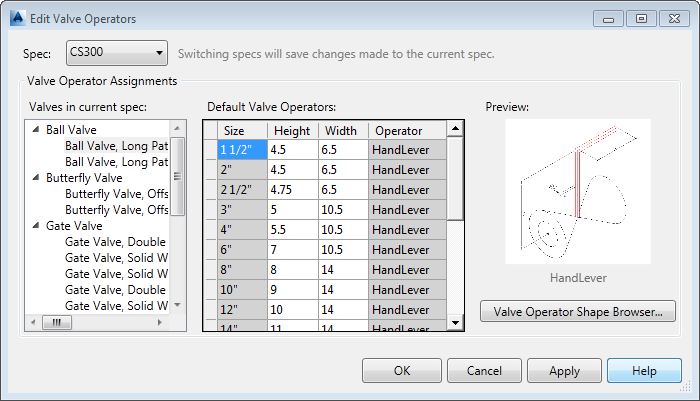

Edit Valve Operators Dialog Box
Specifies default operators for valves in a piping spec.
List of Options
Sets the default valve operator. You can assign an operator based on the size of the valve.
Spec
Lists the specs that are open in the spec editor. You can copy operator assignments to a different spec.
Valves in Current Spec
Displays all valves in the current spec. You can right-click to display copy and paste shortcut menus.
  • Copy Valve Operators - Copies the valve operators to the clipboard. Operator type, shape, and dimensions are included.
  • Paste Valve Operators - Pastes valve operator from the clipboard to one or more selected valve bodies. You can paste to a different valve type or spec.
Default Valve Operators
Sets the default operator to use for the size range.
Valve Operator Shape Browser
Displays the Valve Operator Shape Browser dialog box.
