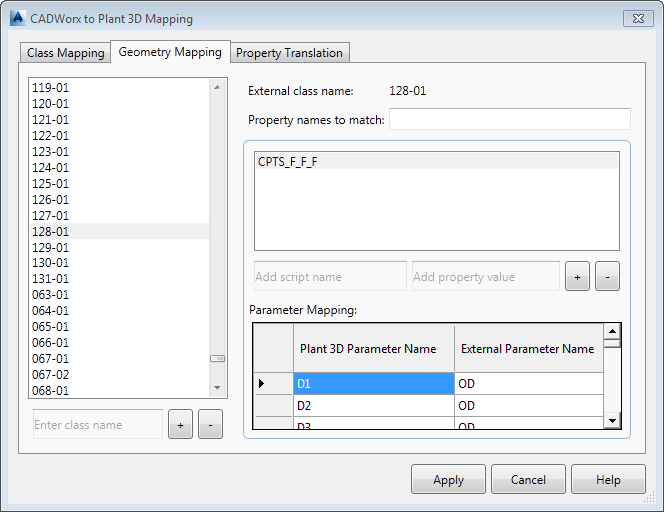

Geometry Mapping Tab (CADWorx to Plant 3D Class Mapping Dialog Box)
Selects graphic scripts and maps dimensional properties or parameters for them.
List of Options
Selects graphic scripts and maps dimensional properties or parameters from them.
External class names
Lists CADWorx class names that map directly to a Plant 3D class.
Add class name
Adds new CADWorx class names to the External Class Names list. Enter text into the box and click the + button to add a class name.
Note:
To reuse an existing script, right-click an existing class to copy the mapping information and then right-click the new class to paste the information. This action affects only this tab.
+ button
Adds a new CADWorx class name to the External Class Names list.
- button
Deletes a CADWorx class name from the External Class Names list.
External class name
Displays the CADWorx class name selected from the External Class Names list on the left pane.
Property names to match
Specifies CADWorx property names to be matched to Plant 3D graphic scripts in varying contexts, if necessary.
Separate multiple property names with commas.
Add script name (required)
Adds a Plant 3D endtype graphics script name to the list.
Add property value
Adds property values for the CADWorx property. In the dialog shown, the property is END_COND_1 and the values are SWF, SCF, BW, and so on.
+ button
Adds a new row that includes the entered script name and property value.
- button
Deletes a selected row that includes the entered script name and property value.
Parameter mapping
Specifies parameter mapping between Plant 3D and CADWorx. Each geometry mapping has a corresponding set of parameters, and these can vary depending on the shape.
The image that follows shows a Plant 3D threaded female tee in the catalog editor (size tab).
The Plant 3D dimension parameters for the shape are listed, and you can enter them in the Parameter Mapping table in the Plant 3D Parameter Name column. You can then enter the corresponding CADWorx property name (or value).
Plant 3D parameter name
Specifies the Plant 3D graphic script dimension parameter to map to the CADWorx parameter.
External parameter name or value
Specifies the CADWorx parameter name, expression, or value to map to the Plant 3D parameter.
