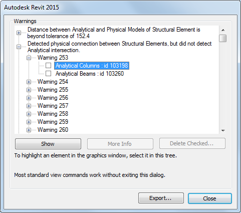

  1. Click Analyze tabAnalytical Model Tools panel Consistency Checks.
  2. When prompted that the elective checking criteria in the Structural Settings dialog is being used to evaluate the model, click OK.
  3. Review the warnings, and make the appropriate changes to your design.
    Example warning - The Analytical Element without Structure parameters
    View of the Analytical Element without Structure parameters
