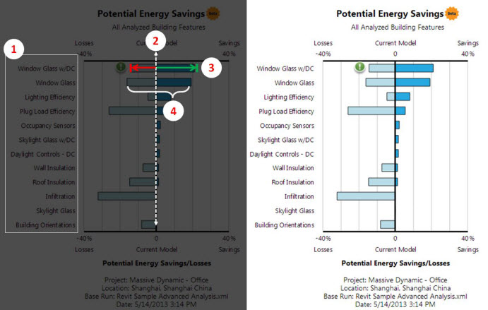

The data in the chart comes from 37 separate energy simulation runs that are run simultaneously in the cloud. Each simulation varies a combination of building features, including aspects like roof and wall insulation, glazing properties, lighting controls, and infiltration. These simulations are designed to test extreme values seen in new and existing buildings and to help design teams get a high-level understanding of how sensitive the building's energy performance is to each parameter.
How to read the chart
1: Building Features Analyzed. Each bar in the chart represents a building feature that is being analyzed to determine its importance to the building's energy performance. A range of design options are tested for each building feature.
2: Current model baseline. The center vertical line at 0 represents the energy performance of the building model, as submitted for analysis.
3: Savings/Losses potential. Features with the highest potential to save energy are at the top of the list. The size of the bar to the right of the centerline is the potential savings percentage, based on the current model. The size of the bar to the left of the centerline is the potential losses percentage.
4: Sensitivity. The overall size of the bar illustrates how sensitive the energy analyses are to this building feature. If this bar is large, a change to this feature can have large impacts to energy use. The size of the bar is also driven by how much the value of this feature is varied with the alternative runs. The runs are chosen to represent extremes.
How to Use the Potential Energy Saving chart
Energy analysis is most valuable when used early and often enough in a project to take advantage of opportunities to make choices that will reduce a building's energy use. Architecture and engineering teams need to work together to scope and prioritize energy efficiency measures. This chart is meant to make that process easier and can be generated easily from any Revit model.
The chart is designed to identify important energy features at a glance:
  • Large bars are important building features affecting energy use (more sensitive). Smaller bars are less important to energy use (less sensitive).
  • Bars that extend further to the right of the baseline have higher potential for energy savings. Bars that extend further to the left have higher potential for energy losses.
Use this data to help focus your design team on the building features that have the biggest impact on energy performance.

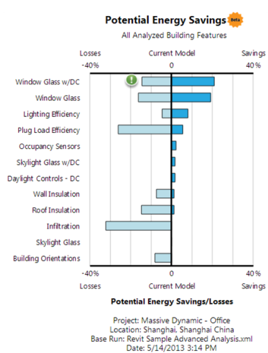

Example: Interpreting the Potential Energy Savings chart
The chart below was generated from this Revit model of an office building and simulated near Shanghai. The bottom of the U-shape is facing south.
