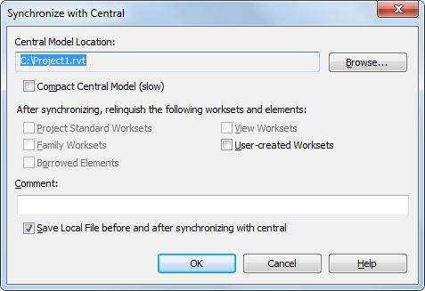

Scenario 5: Synchronize a local file with the central model
You attempt to synchronize a local file with the central model
File-based Server-based
Result: You can use the Synchronize with Central dialog to browse to a different central model. Result: The Browse button is disabled in the Synchronize with Central dialog, and you are not able to change the central model name or location.
