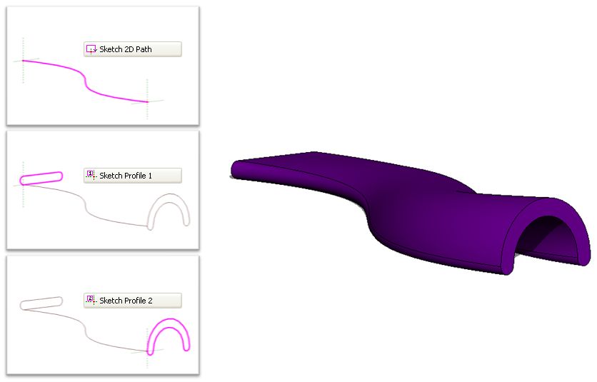

The Swept Blend tool allows you to create a blend that has 2 different profiles and then sweep it along a path. The shape of a swept blend is determined by the 2D path you either sketch or pick and the 2 profiles you either sketch or load.

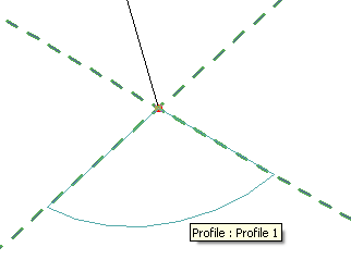

  5. Load or sketch Profile 1.
    The end point for Profile 1 on the swept blend path is highlighted.
