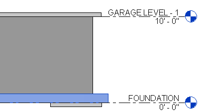

Use the Structural Foundation: Slab tool to sketch a foundation for a model.
Foundation panel
Slab.
Foundation slabs may be used to model structural floors on a grade, which do not require support from other structural elements. Foundation slabs may also be used to model complex foundation shapes that cannot be created using Isolated or Wall Foundation tools.
