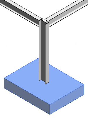

Use the Structural Foundation: Isolated tool to place a footing beneath a structural column.
Click Structure tabFoundation panel Isolated.
Several types of isolated foundations can be loaded from the family library, including pile caps with multiple piles, rectangular piles, and single piles.
Isolated Foundation Instance Properties
Modify instance properties to change an isolated foundation's constraints, rebar cover, structural material, and more.
