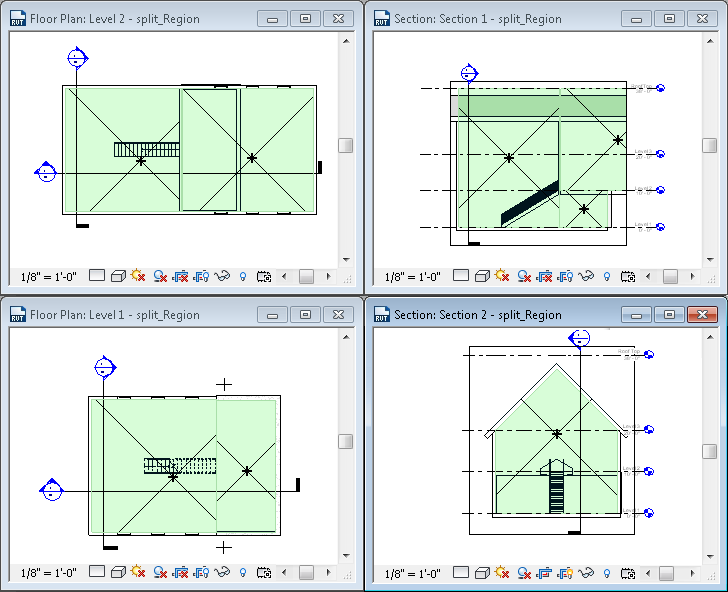

  3. Click View tabCreate panel Section.
  4. In the floor plan view, draw 2 perpendicular sections across the floor plan as shown.
    Make certain that the section line intersects the area that you are placing the space. If not, the space will not display in the section view.
  5. In the Project Browser, double-click the new section view to open it.
  6. This topic assumes that standard levels exist in the design and that they do not need to be created. If levels do not exist, then you need to create them.
  7. Click Modify.
  8. Click in the floor plan to make it the active view.
  9. Click Analyze tabSpaces and Zones panel Space Separator, and draw a space separator to divide the area according to the different upper limits.
    Note: Space separation lines are room-bounding components.
  10. In the Project Browser, open both new section views.
  11. Close all views, except the 2 section views and the floor plan where you want to place the space, and enter WT on the keyboard to tile the 3 views.
    You can also click View tabWindows panel Tile.
  12. Click in a section view to make it active.
  13. Enter VG on the keyboard.
  14. On the Model Categories tab of the Visibility Graphics dialog, scroll down to Spaces.
  15. Expand Spaces, select Interior and Reference (if you want to display reference crosshairs), and click OK.
  16. Repeat to make spaces visible in the other section view and the floor plan view.

  24. In the section and floor plan views, verify that the shaded areas representing the volume of the spaces are constrained from the base level to the level above, and that unshaded areas (caused by such things as cavities or shafts) do not exist. This provides for a more accurate volume calculation.
  25. If the space is not constrained as specified, in the section view, verify that the upper limit of the space is specified to the level above, and redefine the space vertically, if necessary.
    You must also resolve all unshaded areas.
