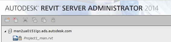

The administrator-level lock applies only to server-based worksharing, as it is used to facilitate Revit Server Host maintenance operations where activity in a model (or a collection of models) should be halted. For example, a model’s state should be frozen before the model is archived. Failure to do so could result in an archived copy containing partly committed changes from an update, and this copy would be unusable. If an administrator-level lock is applied first, the model state is guaranteed to be quiescent, and this pitfall can be avoided.
An administrator-level lock is applied using the Revit Server Administrator web-based management utility (or its command-line utility counterpart). The lock can be applied to an entire Revit Server Host, all the models in a folder, or a single model.
To apply an administrator-level lock to an item
When an item is locked:
The lock is actually applied in 2 stages. First, all in-progress operations are allowed to continue while new ones are blocked. When the in-progress operations have all completed, the lock is fully committed and further access is unconditionally blocked until the lock is released.
Administrator-level locks rarely require any kind of manipulation. However, if there are any malformed central models (perhaps because a first-time save of a new central model failed), Revit Server may not be able to properly create or release an administrator-level lock. In this case, the lock can be removed by deleting the super.lock file from the Revit Server Host’s root project storage directory. (Note that the offending malformed model should also be removed to prevent the problem from reoccurring.)
