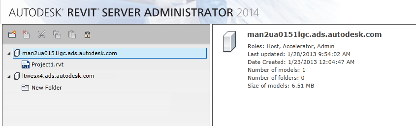

Use the Revit Server Administrator to manage folders and central models on Revit Server Hosts and to lock models for administrative activities.
The left pane of the Revit Server Administrator provides an editable tree control, the top level of which displays all Revit Server instances listed in the RSN.ini file on the Revit Server instance where the Revit Server Administrator is running. The right pane displays detailed information about the selected Host and identifies which other roles may be enabled for it.

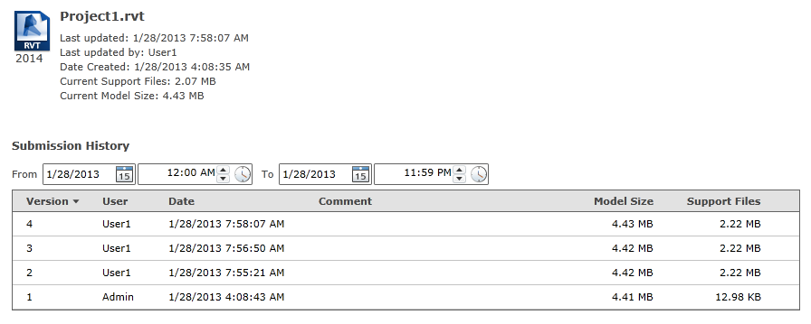

When you select a model in the tree control, the right pane displays a history of the edits that have been submitted, including any comments entered by team members, as shown below. Use the date filter to display items between specified dates.

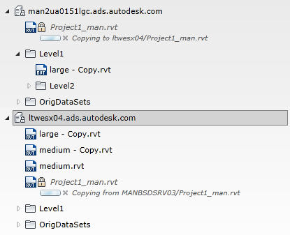

tools located above the tree control as needed to modify the hierarchy of folders and models for a Revit Server Host, or to move a model from one Host to another (moving folders among Hosts is currently not supported). Changes that you make are reflected in the file structure that is navigated using the Revit Open and Save dialogs.
To move a model from one Revit Server Host to another
(Cut) or
(Copy).
(Paste).
