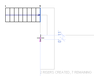

To create 2 perpendicular runs connected by a landing
  1. Selecting the Run Component Tool and Specifying Options and specify initial options.
  2. On the Options Bar:
    • Select a value for Location Line. (Run: Right is selected in the illustrations that follow.)
    • Verify that Automatic Landing is selected.
  3. Click to start the first run.
  4. Click to position the landing when the desired number of risers has been reached.
  5. Move the cursor along the extension line, and click to start drawing the remaining risers for the second run. Notice that the landing is created automatically. (The default landing depth is the same as the run width.)
  6. Click to finish the second run.
  7. On the Mode panel, click (Finish Edit Mode).
