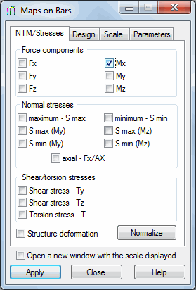

Open the Maps on Bars dialog using either of the following methods:
This option displays for bar structures, color maps obtained from the analysis of sectional forces, stresses, deformations, and so on, within a structure.
The dialog consists of four tabs:
For a structure, you can display only one quantity.
To display a map of a quantity in the viewer (Robotdrawing area):
