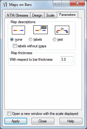

Click the Parameters tab in the Maps on bars dialog, to select the manner of presenting maps on structure bars.
The dialog contains the following options.
- Map descriptions lets you decide how to present the descriptions of the quantities on maps.
- none - Descriptions in maps of the quantities in the Maps on bars dialog are not displayed
- labels - Descriptions in maps of the quantities in the Maps on bars dialog are displayed as labels showing values at the selected points on bars
- text - Descriptions of the quantities in the Maps on bars dialog are displayed as values at the selected points on bars
- labels without maps - Only descriptions (in the form of labels or text on bars) are displayed for structure bars, without maps of a selected quantity.
- Map thickness lets you define a digit, which determines the ratio of the line used when displaying a map to the thickness of a line when displaying structure bars.
