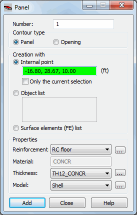

After the option is selected, the Panel dialog displays.
To define a panel, specify its parameters:
- Number
- Contour Type
- Panel
- Opening
- Face (option available only in Volumetric Structure Design)
If Face is selected for Contour Type, all options under Properties become unavailable. Selecting this option causes the object that is being generated to be defined as a face (without assigning properties such as reinforcement type and thickness). Such an object can be used during generation of a volumetric structure (solid) and it may constitute a face of such a volumetric object.
- Creation With
- Internal Point
- Object List
- Surface Elements (FE) List
- Properties
- Reinforcement - type of reinforcement for the panel
- Material - this is a read-only field; it displays the material defined for the selected panel thickness.
- Thickness
- Panel calculation model.
