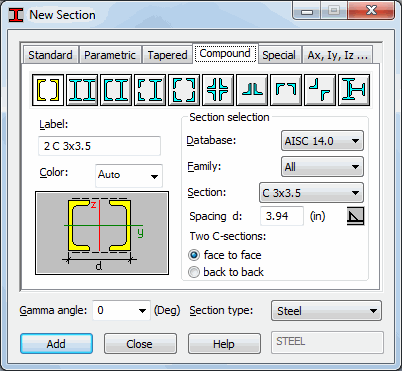

The following image shows the Compound tab on the New Section dialog.

The dialog specifies data for a selected type of compound section (type and chord spacing). It is very important that a label for a compound section has information about the sections from which the section chords are defined. This information is significant when designing compound sections. Data about the chord connection method (battens or bracings) is saved in member code parameters. The parameters of chord connections can be specified in the buckling diagram dialog. This dialog opens when you define steel member types. When designing a member using a compound section, you can distinguish 3 levels of verification:
The following elements can be defined on the Compound tab:
When the Two C-sections option is selected, you can set the C-sections with respect to each other:
Similarly, when the C-section and I-section option is selected; the C-section and I-section can be set back to back or face to face with respect to each other.
When the Two angles option is selected, the angles can be set with respect to each other:
