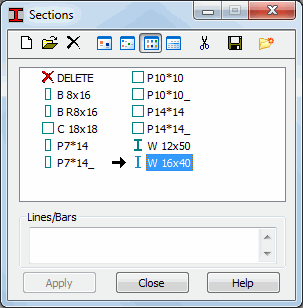

The Sections dialog assigns sections to structure bars directly. It has:
- Active list field - List of sections defined by a user. These sections can be assigned to structure bars.
- Active selection field (Lines/Bars) - Displays the current selection of structure bars. Any section from the active list can be assigned to the selected bars.
- Standard buttons (Apply, Close, and Help).
The active list has information about the label and the section type.
The following icons are at the top of the dialog.
- Adds a new section type or lets you select a section from a section database (New Section Definition).
- Lets you select a section from a section database (Selection of a bar section from an available section database).
- Deletes a section type from the active list.
, and
- Displays the list of active section types as: large icons, small icons, a short list, or as a full list.
- Deletes all section types from the active list that are not in the structure.
- Lets you save the section highlighted in the active list to a database. When clicked, the Save to database dialog opens, which lets you select the database for saving the section.
- Opens the Label Manager dialog.
When the full list is selected, the parameters of the sections are displayed:
- If x displays in the second column, this section has already been used in the structure.
- The default material for the section displays in the third column.
- The value of the Gamma angle displays in the fourth column.
