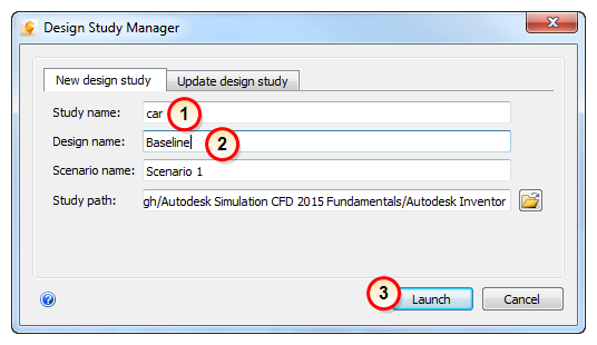

3. In the Design Study Manager, assign names to the design study, design, and scenario
Design study name = car
Design name = Baseline
Click Launch
When launching from Pro/Engineer, a prompt appears about running with interferences. Select "Yes" to proceed.
