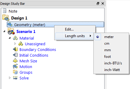

Use the Geometry branch to perform these three primary functions:
Geometry settings made to a design apply to all scenarios within a design.
Note: All designs in a design study must have the same length units.

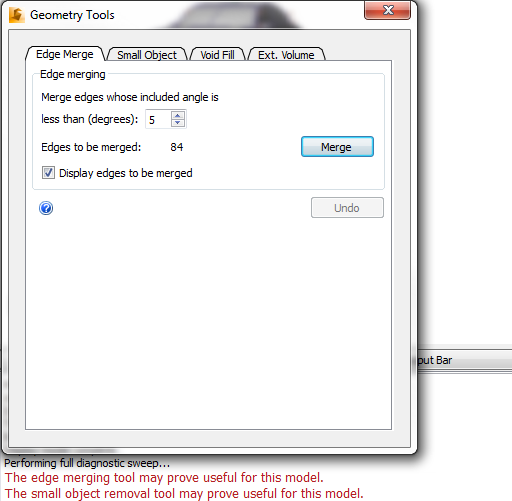

Geometry Tools allow for the modification and creation of geometry in the Autodesk Simulation CFD interface. Tools like Edge Merging and Small Object Removal enable you to reduce the complexity of certain geometric features and therefore increase the speed of your analysis. Void Fill Creation and External Volume Creation provide the ability to create flow geometry inside the design study, separate from the original CAD geometry.
To access the Geometry Tools, click Setup > Setup Tasks > Geometry Tools. Alternatively, right click on the Geometry branch of the Design Study bar, and click Edit...
Edge Merging unifies edges that meet at a common vertex at an inflection angle less than a specified tolerance. This tool provides the benefit of reducing the number of edges, especially small ones, which leads to reduced overall mesh density, and faster analysis times.
The inflection point is determined by the included tangency angle which has an upper limit in the Edge Merging dialog of 15 degrees.
About Edge Merging
Edge Merging will have no effect if more than two edges meet at a vertex (as shown on the left). Likewise, it will not merge edges that meet at an included angle larger than the specified angle (shown on the right):

In Exercise 1, we closed the Geometry Tools dialog, even though messages advised that several edges could be merged and that using Geometry Tools would be helpful.
Why?
After examining the model, it was clear that most of those edges are on external surfaces of the car. Because the intent is to study the flow inside the cabin, Geometry tools would not improve the analysis performance.
