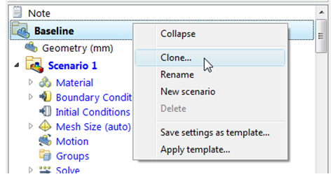

1. Right click on the Baseline design in the Design Study Bar and select Clone…
2. Enter the name “Floor Registers Active” to the cloned design. Click OK.

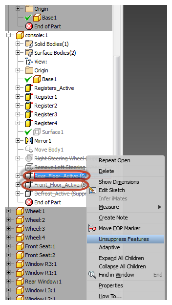

3. In the CAD model, enable the features that allow air to flow to the front floor and the rear floor registers. In the console part (or console-r part for the right-drive configuration), activate the following features:
Autodesk® Inventor
Autodesk® Fusion

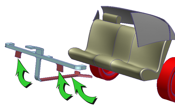

Instead of modifying the model in Autodesk® Fusion, we will change the material definition of the three floor-level ducts to air in Autodesk® Simulation CFD:

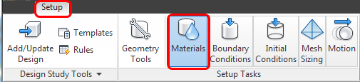

  1. Click Materials from the Setup tab.
  2. Hide the Car Body, Cabin Air, and Console parts to reveal the ducts.
  3. Select the three floor-level ducts:
  4. Assign Air:
Material DB Name = Default. Type = Fluid, Name = Air. Click Apply.

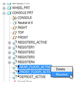

PTC Creo or Pro/Engineer
UG NX
Make console part (or console-r part) the working part and activate the part navigator. Check the box to enable each feature.

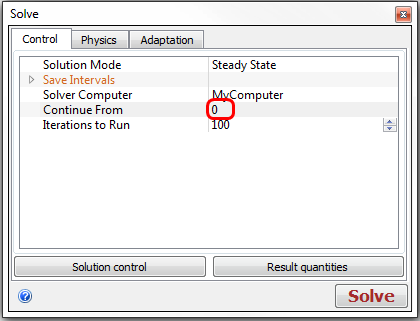

7. Set Continue From to 0 and click Solve.
8. When prompted if you want to delete all results after iteration 0 and continue, click Yes.
