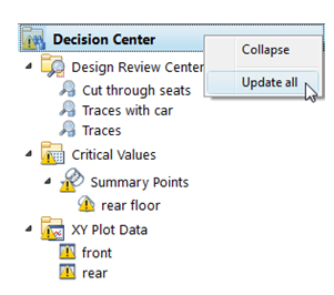

1. To begin, open the Decision Center by clicking the Design Study bar icon.
Note: An alternative way to toggle the Decision Center is to tap the space bar: Tap once to show the Decision Center, again to hide the Design Study bar, and again to show Design Study bar without the Decision Center.
2. To update all images, values, and plots to include the new design, right click on the Decision Center bar and select Update all.
Note: The "warning" symbol adjacent to the objects in the Decision Center indicates that one or more scenarios in the design study are either not included or are not current in the Decision Center object. Clicking Update all extracts the latest results from all scenarios, and applies them to the decision center objects.

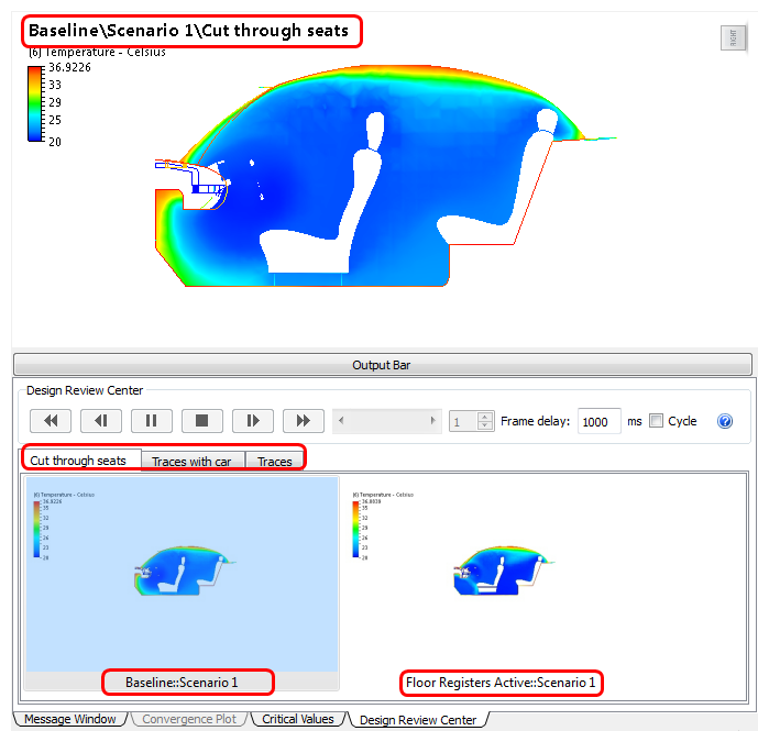

3. Click the Cut through seats Summary Image (under the Design Review Center branch).
Note: Note that the saved view of the baseline design is displayed.
Note: Each Summary Image is listed as a unique tab on the Output Bar. Each tab displays the saved Summary Image for all completed scenarios in the design study.

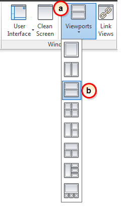

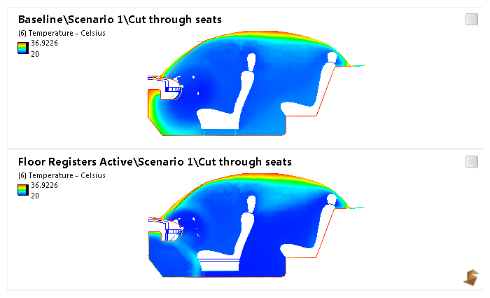

4. To view the Summary Image for both designs simultaneously, divide the graphics window into two viewports:
  1. Expand the Viewport menu on the View tab.
  2. Select Horizontal split views.

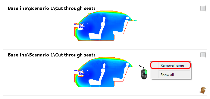

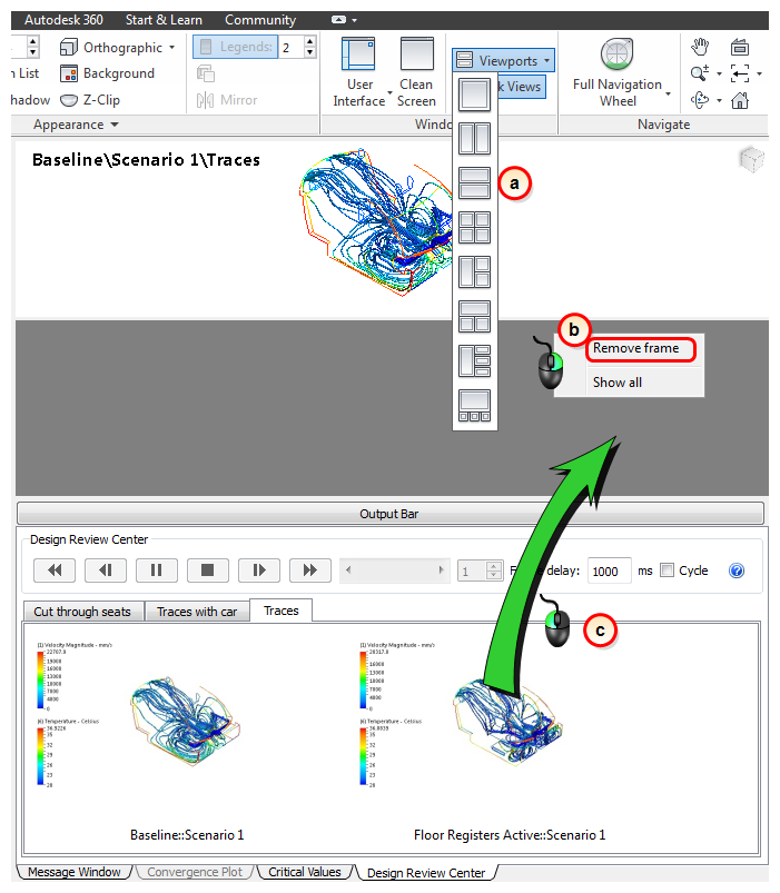

5. Both viewports display the same image. To remove one of the images, right click in the lower viewport and select Remove frame.

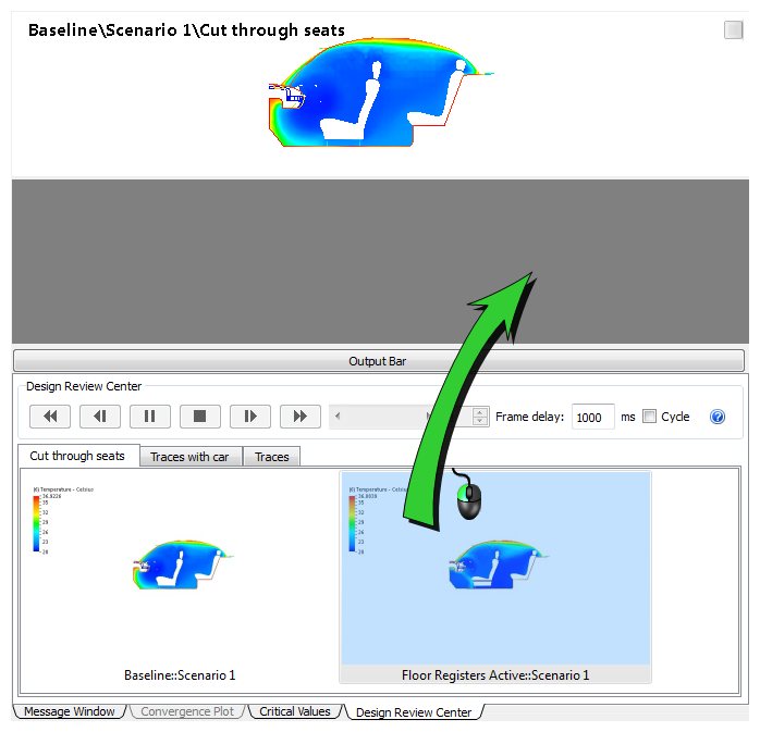

6. Drag the Floor Registers Active image from the Output Bar into the lower viewport.
Note the much cooler temperatures in the new design, shown in the lower viewport. Also note the more uniform cooling of the rear occupant space:

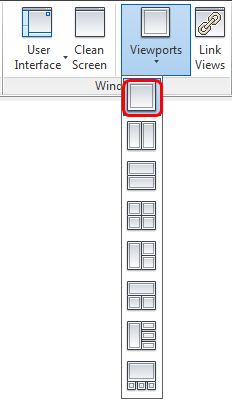

7. Display a single viewport from the Viewports menu.

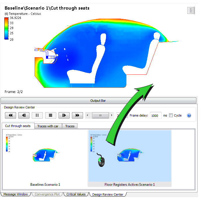

Note: An alternative way to compare design results is to place the summary image from both designs into a single viewport, and animate the display.
8. Drag the image not currently displayed in the viewport from the Output Bar into the single viewport. (The Floor Registers Active image is shown being dragged below.)
9. Use the "VCR" controls or the slider bar to animate between the two designs.

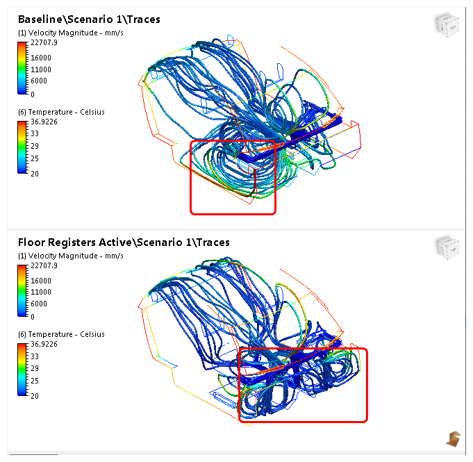

10. To view flow pattern changes, click the Traces Summary Image (under the Design Review Center branch).
11. Compare the results from the two designs using the Traces Summary Image:
12. To navigate the views together, make sure that Link Views from the View tab is pressed.
Note: The recirculation that caused the uneven heating in the baseline design is eliminated in the new design. Note, however, that there is some recirculation at the front of the floor space.

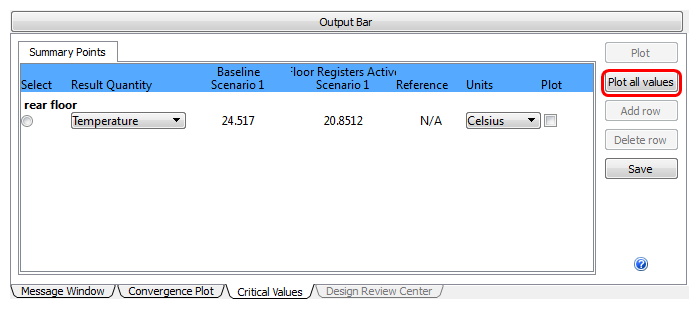

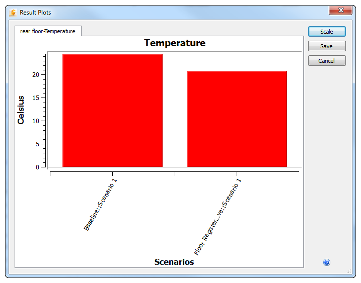

13. Select the rear floor summary point from the Critical Values branch of the Decision Center.
14. Display the differences by clicking Plot all values.
Note: Note the reduction in temperature at this location in the new design:

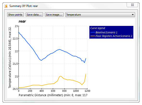

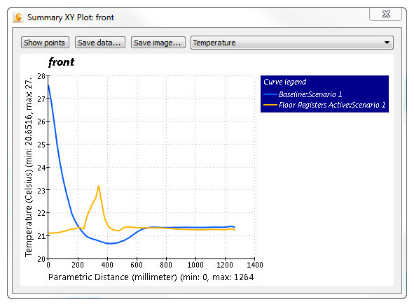

15. To view the temperature plots of the front and rear occupant space, click the front and rear Summary XY Plot entries (under the XY Plot Data branch).
Observations:
