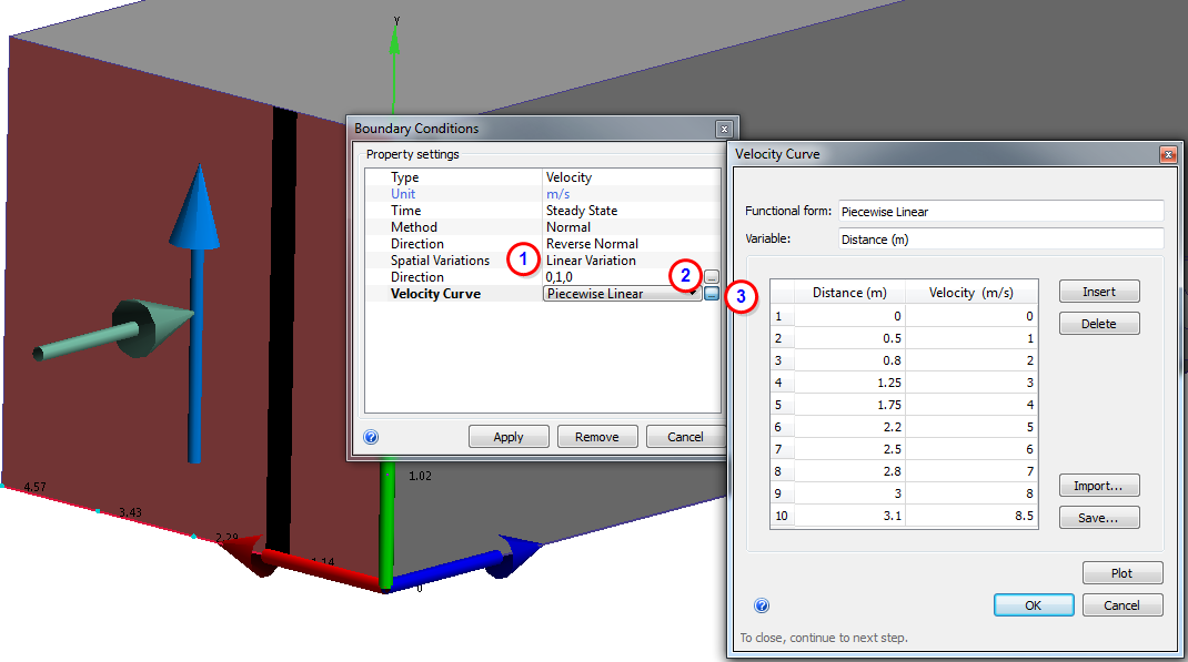

To assign a linear variation to either a velocity or temperature boundary condition:
  1. From the Boundary Condition quick edit dialog box, select Linear Variation from the Spatial Variations row.
  2. To set the variation direction across the selected surface, either key in a unit vector in the Direction row, or click the value in the Direction field to open the Vector dialog. Select the vector direction or a surface that is normal to the intended direction.
  3. To define the variation, click Piecewise Linear. Enter the values and distances in the table. The distance increases in the defined direction of the variation. Simulation CFD ignores values specified at distances that exceed the dimension of the surface.
