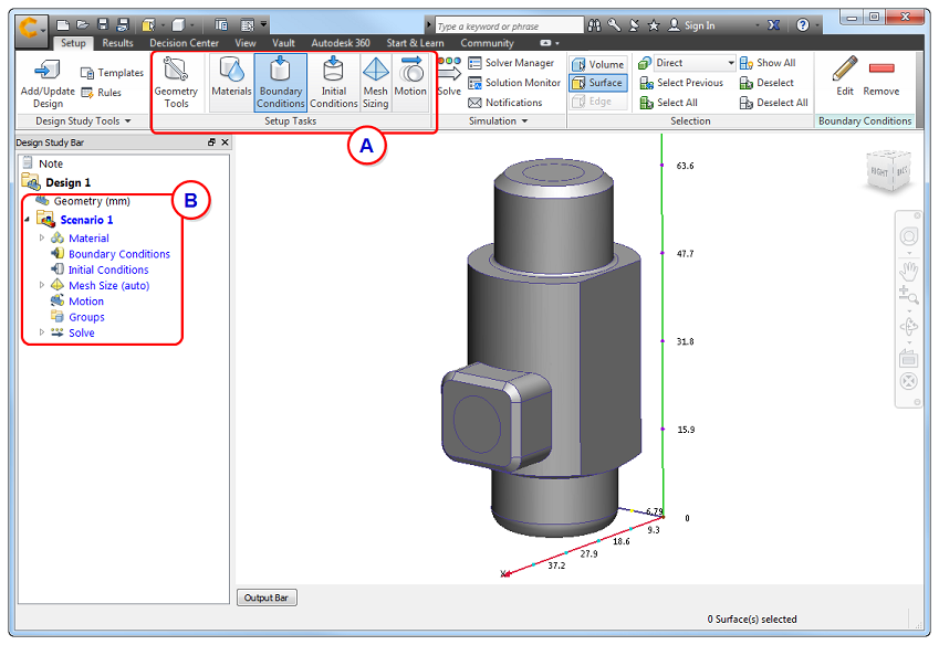

To begin, enable the Boundary Condition task from either the Setup (tab) > Setup Tasks (panel) (A) or from the Design Study bar (B):

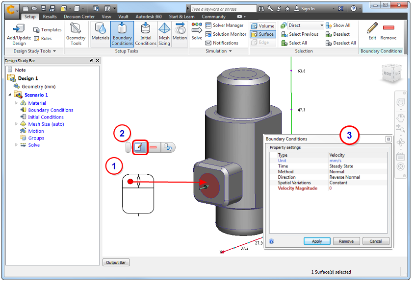

To work close to the model:

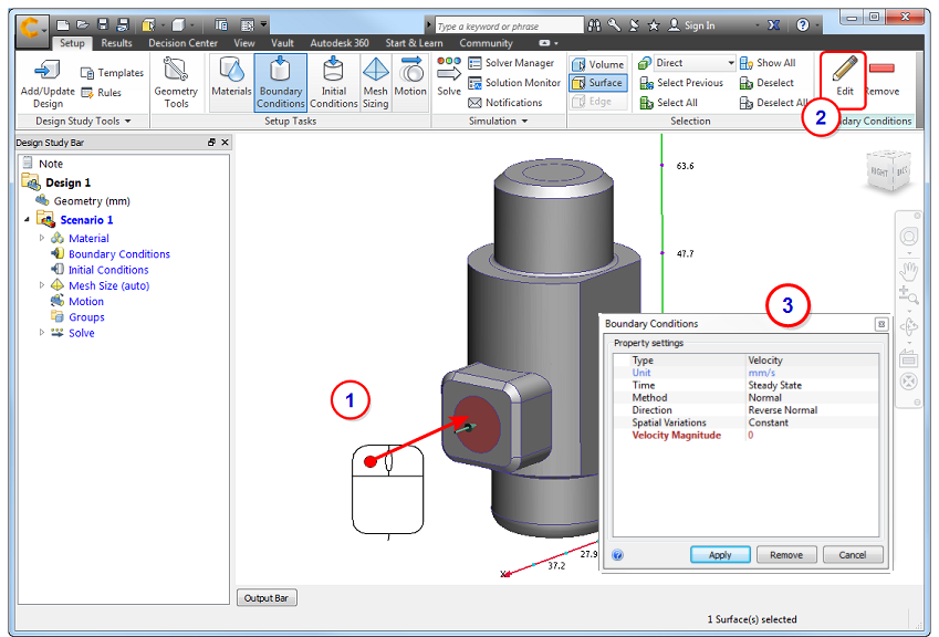

Alternatively, right click on the model entity or branch on the Design Study bar, and click Edit...
To work away from the model:
To assign the boundary condition in the quick edit dialog:

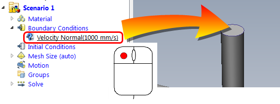

Design Study Bar
All conditions are listed below the Boundary Conditions branch of the Design Study bar:

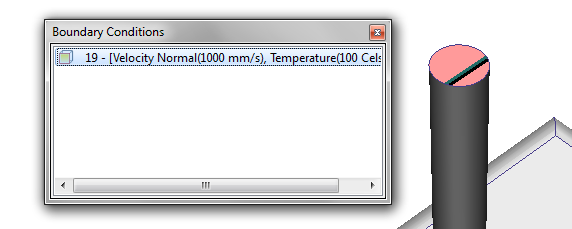

Selection List
To see the conditions applied to a specific entity, enable the Selection list, and select the entity:
To enable the selection list, click the toggle in the Quick Access toolbar:
