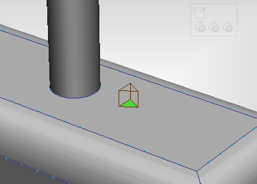

A small prism indicates the element size:
